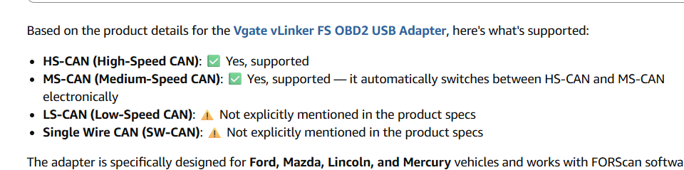

I’m using windows laptop With vlink FS usb and I have installed sgw Bypass. Is there a chance that low battery health could impact this?
Low battery may be an issue, but I would look at the COM port settings in Windows first. Check this Library post Multiecuscan (MES) Setup and Connection Timeout Troubleshooting

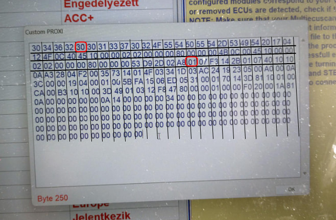

I just found it, and I was wandering to change my battery settings. (A few months earlier, I changed the battery 80Ah/H7 Flooded → 95Ah/H8 AGM.) - 2.2 Diesel
My default proxy values:
byte 5: HEX 30 (0011 0000) / (I don’t understand why the last 4 digit is zero)
byte 63: HEX 01 (0000 0001) or (0001 this should be the last 4 digit) / 80Ah, 680A.
Am I understand correctly, I should be change these two values according to the list just convert the given binary values to HEX?
eg.:
byte 5: binary (xxxx 1011) → HEX 0B (zero+B or simply just “B”?)
byte 63: binary (xxxx 0010) → HEX 02 (zero+2 or simply just “2”?)
So the change in HEX:
byte 5: 30 → 0B
byte 63: 01 → 02
Or I have to keep the first 4 binary digit from my original value?
byte 5: binary (original first 4 digit: 0011 + new last 4 digit: 1011 = 0011 1011) → HEX 8B
byte 63: binary (original first 4 digit: 0000 + new last 4 digit: 0010 = 0000 0010) → HEX 02 (zero+2 or simply just “2”?)
Here is my proxy:
Then I need to do a proxy alignment?
For your help, thanks in advance!
Best regards: Süti

There was misinformation in the post. I updated it with more accurate byte/bit information…
Body → CAN Setup
Battery type
byte 63, bits 0-3 (bit order is: 76543210):
  • xxxx0001 - 80Ah 680A - default setting for Giulia/Stelvio EU
  • xxxx0010 - 95Ah 800A - default setting for Giulia/Stelvio US
  • xxxx0011 - 80Ah 680A - default setting for diesel Giulia/Stelvio
  • xxxx1000 - H7 flooded;
  • xxxx1001 - H7 AGM;
  • xxxx1010 - H8 flooded;
  • xxxx1011 - H8 AGM - default setting for Giulia/Stelvio MY20 models US/EU

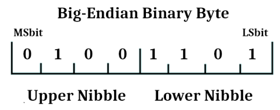

You would take your existing byte 63 value “01” and convert to binary “00000001” and update bits 0-3, so your new binary value for byte 63 is “00001011”. Then convert that to hex for the value to enter in to byte 63: “0B”
Most Significant bit is on the left (#7) and Least Significant bit is on the right (#0)… fyi fwiw

I missed that you had the LS usb version. I wonder if it is incapable of talking to all of the CAN busses without the use of an adapter cable…
I use the vGate vLinker MS which can talk to all of them.
What adapter i need to use in order to change that setting.
As stated, I use the vGate vLinker MS bluetooth and have good success with that. No cables needed. When it tells you to use a certain cable color, just click ok/next/continue.
