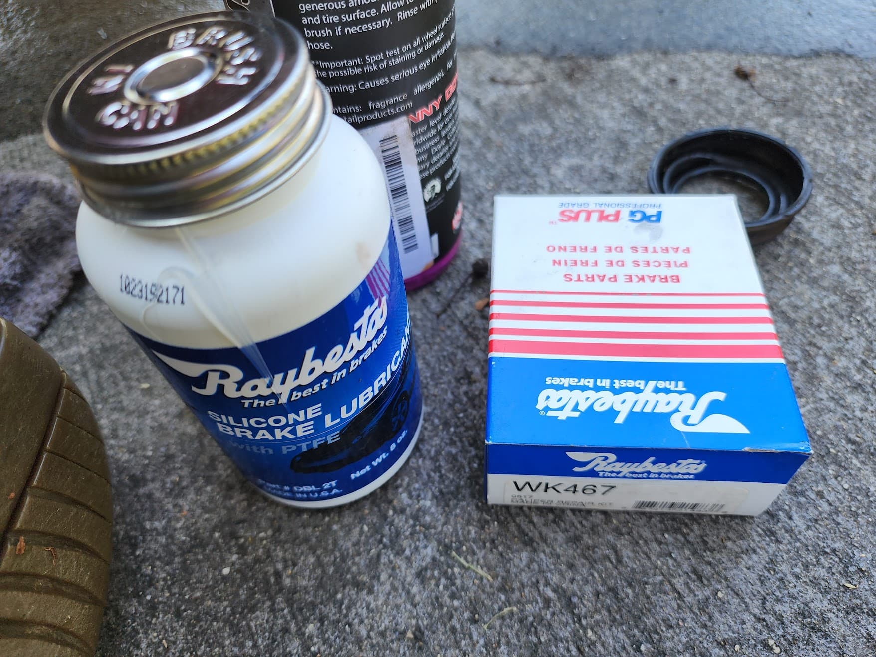

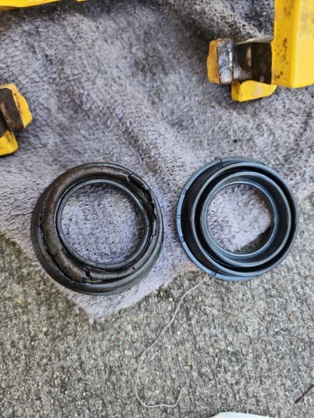

Was taking my track pads off and decided to finally replace a cooked rear dust booot (why is the forcing correct to trunk?! lol) that has been bad for over a year. I bought the Raybestos WK467 kit that fits our ATE caliper perfectly. Also used Raybestos Silicone lubricant.
