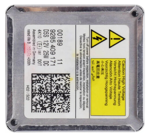

Mid Level:
- Watts: 25W
- Size: D5S
- Ballast: Integrated with bulb

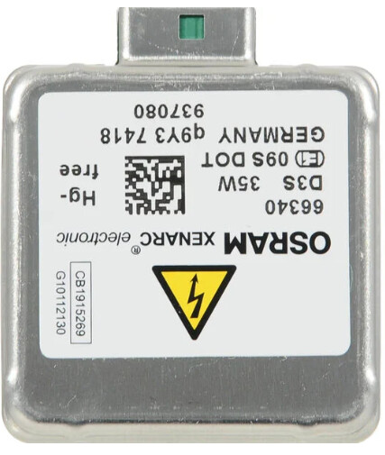

Premium or Top Level:
- Watts: 35W
- Size: D3S
- Ballast: Externally mounted on headlight assembly

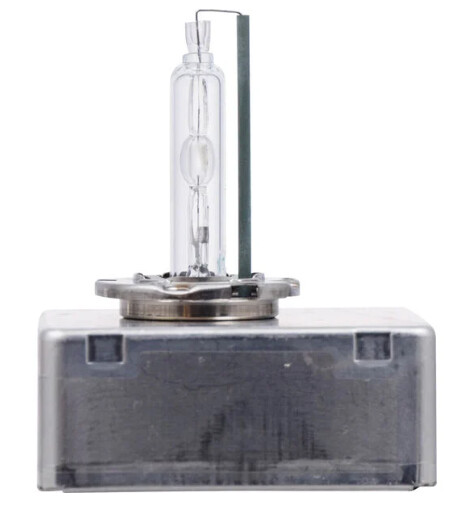

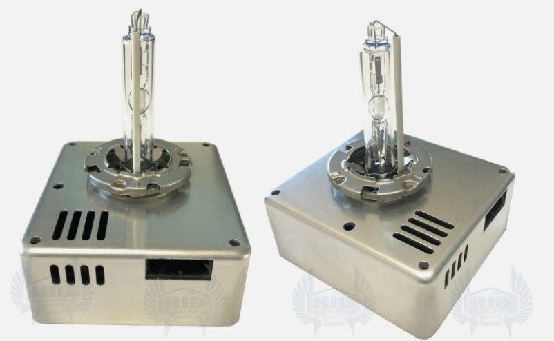

Upgrading
In order to upgrade from the 25W D5S bulb to a 35W version, as you would suspect, all you need to do is find a 35W D5S bulb! There are limited options out there, but if you search a bit on eBay, Amazon, or other lighting stores, you should find something that fits the bill. To match the color of the SBL and DRL LED lights, you are looking for a bulb in the 5200K - 5500K temerature range.
Note: It has been reported, and also experienced by me, that the AliExpress options may not be so reliable. I received a set (1 months later) where one of the bulbs was completely non-functional. Other people have reported that even though they were marketed as a D5S size bulb, they did not physically fit. BUYER BEWARE
The headlights that I ended up purchasing were a set from eBay, HERE, in the 5500K flavor. They have been going strong for over 2 years as of writing this.
