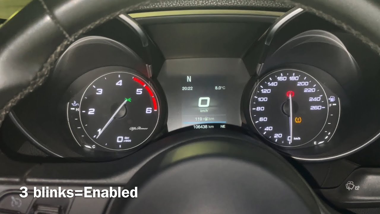

I added another function to disable ESC and TC in D,N,A (and enable them in R). The video better explains it:

I made some tests on the functionality that disables and enables ESC and TC. This is the video:

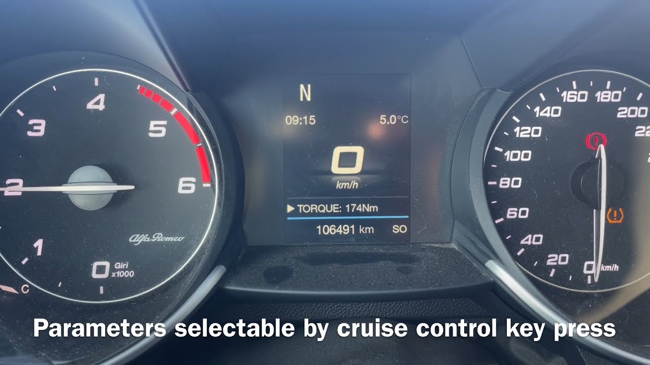

I’m adding a menu on dashboard to show additional parameters:

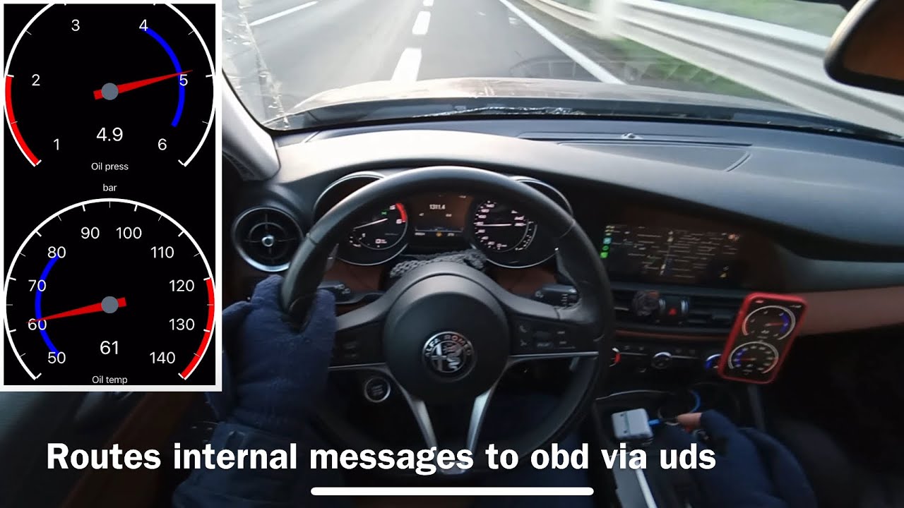

New function added to route native messages over uds to pass obd filter:

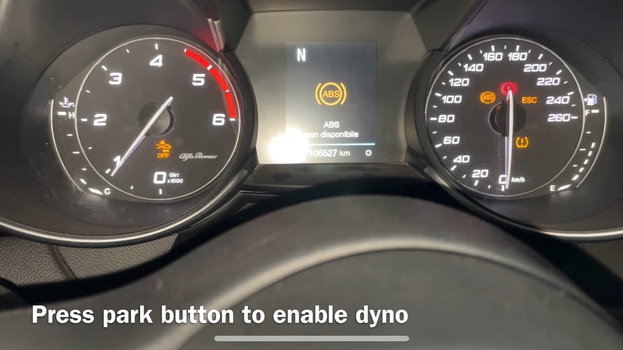

New function added: Dyno mode

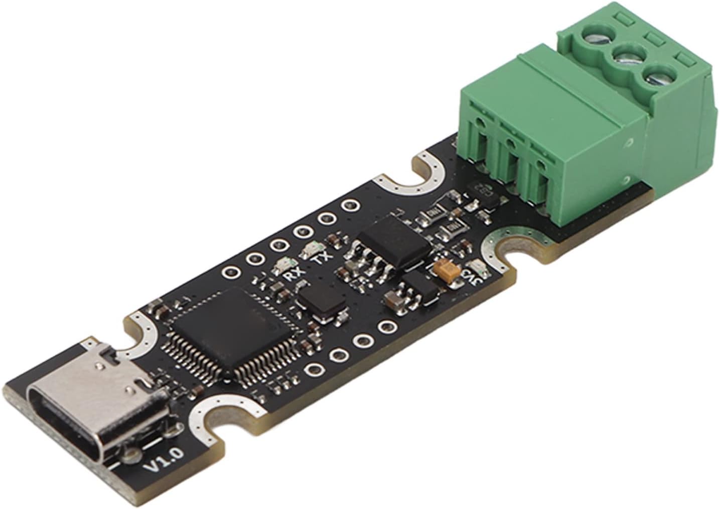

I just ordered parts. Here are the US Amazon links to products I believe are compatible…
Buy Pomya USB to CAN Adapter Board Based On STM32F072 Support for CAnable for Candlelight for Klipper, Type C Interface, Supports CAnable, Candlelight, Klipper, USB to CAN Converter Adapter: Electronics - Amazon.com ✓ FREE DELIVERY possible on...

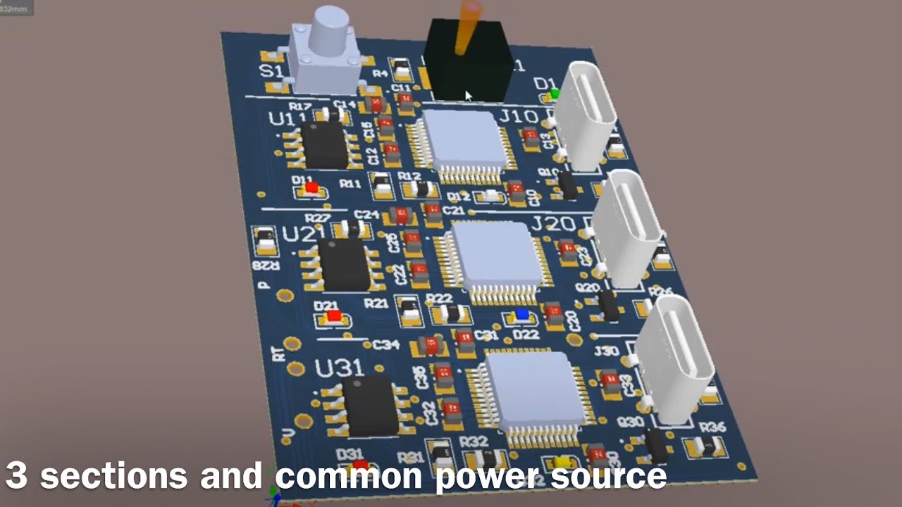

I developed a new pcb for BACCABLE:

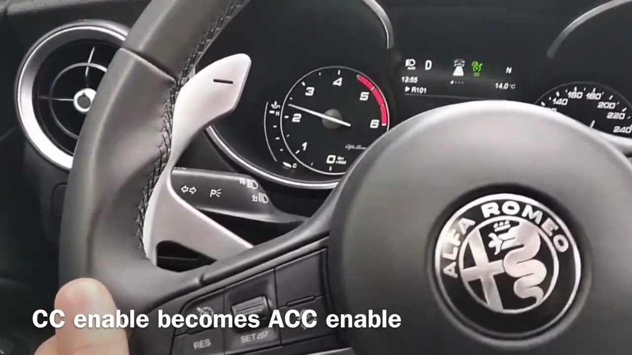

Added function to obtain Adaptive Cruise Control without changing the buttons pad.
