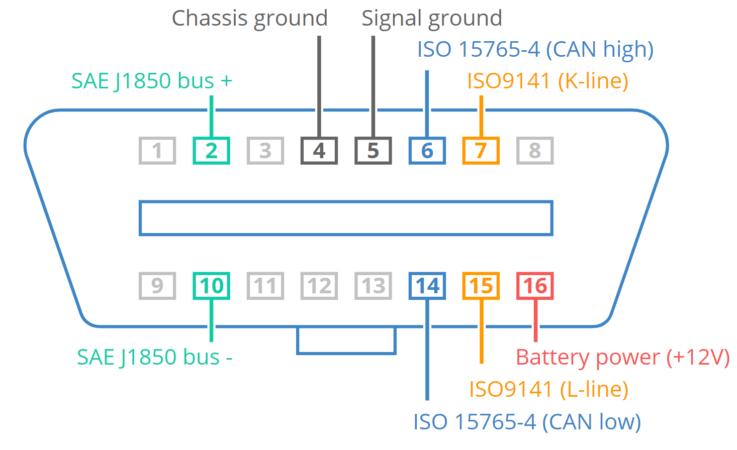

At first, I was going to look for someone who had Artem’s dongle somewhere in the US that wanted to lease it to me, but it turns out that I had the necessary components already. A Raspberry Pi 4 and a PICAN3 CAN hat. I ended up butchering an old OBD reader to use the connector. Super simple wiring only needs ground, 12v+, CAN High, and CAN Low. (See diagram)
